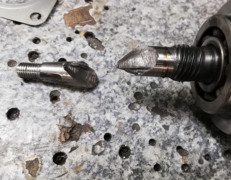

Re: Kymco epic fails worst of ....
Agility 16+ die 2.
Trotz neuer Kurbelwelle, Lager, Polrad ect. Gruss Christian
Agility 16+ die 2.
