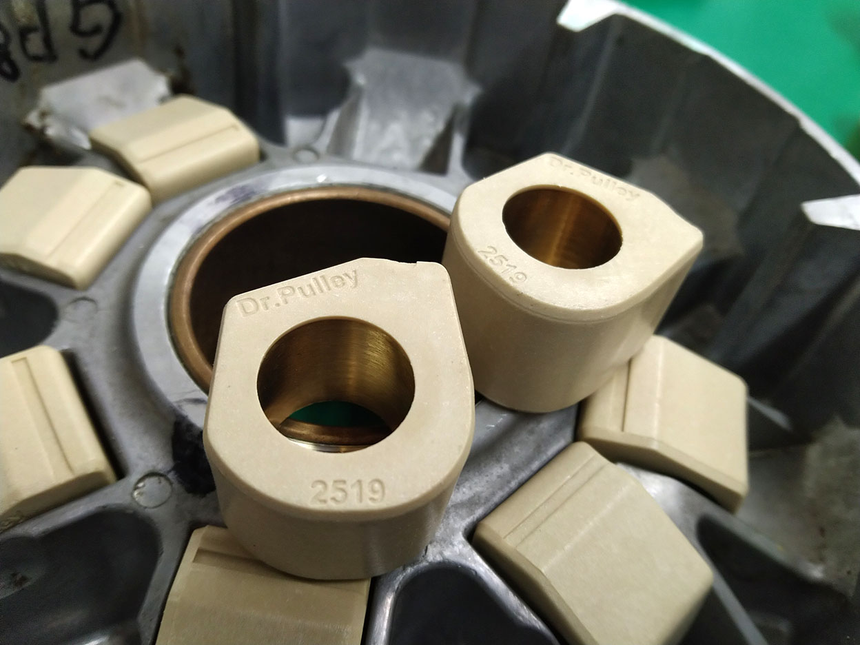

Cubi says "Normal DrPulley SR is without side wing" the reason is mostly the SR with wing can only fitted for one variator that the SR with wing designed according to.
Photo 1, is GP800, SRV850 OE roller
photo 2 ,showing the side wing of Piaggio design lean over on the Ramp wall
Photo 3, is SR2519 without side wing
Photo 4, is SR2519 without side wing installed in OE variator
Normally, the Piaggio design OE roller with side wing is fitted for OE variator and in this case the funtion of side wing is more obviously.
4.Aftermarket roller no wing SR2519 - Dr.Pulley - 2.jpg (150.89 KiB) 1354 mal betrachtet
3.Aftermaket roller SR2519 - Dr.Pulley - 1.jpg (156.7 KiB) 1354 mal betrachtet
2.Piaggio design OE roller 2519 with wing lean over ramp wall - - 2.jpg (143.59 KiB) 1354 mal betrachtet
